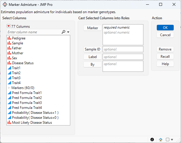

To estimate the proportional contribution that each population made to each of your samples, launch the Marker Admixture platform by selecting Analyze > Life Sciences > Marker Admixture.
Figure 6.2 The Marker Admixture Launch Window
The Marker Admixture launch window contains the following options:
Marker
Select the marker columns that you want, and click Marker to specify the markers that you want to analyze.
Sample ID
Use this option to specify one variable whose value can provide a unique identifier for each row.
Label
Use this option to use the values in the specified column to label the samples in the plots. Values in the specified column do not have to be unique.
By
Produces a separate report for each level of the By variable. If more than one By variable is assigned, a separate report is produced for each possible combination of the levels of the By variables.
After you specify these options, click OK to open the Marker Admixture - Launch window, where you specify the remaining options.

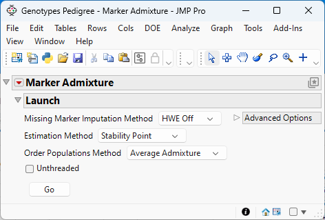

Figure 6.3 The Marker Admixture - Launch Window
Missing Marker Imputation Method
Use this option to specify how missing marker values are to be imputed. Because the Marker Admixture method does not run when your data is missing marker data, you must impute any missing data.
– Select HWE Off to impute the missing genotypes with random draws from a multinomial distribution in which the frequency of each genotype class is set to be the observed frequency from the data.
– Select HWE On to impute the missing genotypes with random draws from a multinomial distribution in which the frequency of each genotype class is set to be the expected frequency under the assumption of the Hardy-Weinberg equilibrium (HWE).
– Select Random to randomly assign one of the acceptable values (0, 1, 2, ..., K (where K is the ploidy level)).
– Select Specified to impute the missing genotypes with a specified integer between zero and the ploidy number.
Estimation Method
Use this option to specify the method that is used to estimate the number of ancestral populations and, hence, the number of clusters, to group the samples.
– Select Stability Point to enable the algorithm to calculate the optimum number of ancestral populations.
– Select Fixed Parameter if you know the number of ancestral populations. Specify this number by using the Number of Ancestral Populations advanced option.
Order Populations Method
Use this option to specify how individuals are sorted in the report.
– Select Average Admixture to sort the individuals by using the average admixture probabilities of the individuals.
– Select Variance Explained to sort the individuals by using the variance in the admixture probabilities of the individuals.
Unthreaded
Use this option to suppress multithreading. Deselect this option for improved computational speed.
Set Random Seed
Use this option to specify a nonnegative integer to start the random number stream. Different values produce different outcomes of the algorithm. This option is available when HWE Off, HWE On, or Random is selected as the imputation method.
Use this option to specify the number of ancestral populations. This option is available only when Fixed Parameter is specified as the Estimation Method.
Imputation Value
Use this option to specify a value to insert into any cell that containsing a missing value symbol. This option is available only when Specified is selected as the imputation method.
After these options have been specified, click Go to run the analysis.
