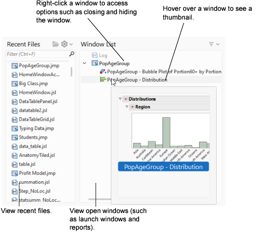

The JMP Home Window provides instant access to open windows and files. Opening recently opened files, closing windows, and pinning frequently used files are a few of the options.
JMP Home Window on Windows
On Windows, the JMP Home Window appears when you open JMP. On the JMP Home Window, you can perform the following tasks:
• Open recent files in the Recent Files list or pin a frequently used file.
• Right-click files in the Recent Files list to perform common tasks.
• Open or close active JMP windows in the Window List.
• Set an open data table as the current data table by selecting it from the data table list at the top.
Figure 2.14 JMP Home Window Actions

Window List
On Windows, the Window List shows open JMP windows, such as data tables, reports, and scripts. You can open, close, rearrange, and hide JMP windows.
• If you hover over a file in the Window List, a thumbnail appears.
• To open the Window List in its own window, select View > Window List.
• To display windows side-by-side, right-click the selected windows and select Arrange.
• To always automatically display the Window List inside maximized windows, select File > Preferences > Windows Specific and select Dock the Window List in maximized windows.
Right-click files to access the following options:
• View a window.
• Close a window. (Alternatively, you can select files and press Delete.)
• Close all windows except the currently selected window. (If the selected window is a report window, the dependent data table also remains open.)
• Move a window to the back.
• Hide a window from the Windows taskbar or unhide a window.
• Select all windows, or clear all selections.
Note: The active file is formatted with bold text.
