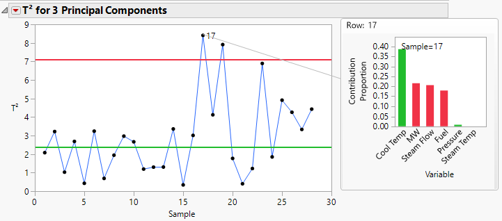

Model-driven multivariate control charts are used to monitor parameters for multiple processes in a single control chart. The Model Driven Multivariate Control Chart (MDMVCC) platform enables you to build a control chart based on principal components or partial least squares models. For a set of continuous variables, the MDMVCC platform uses principal components to build the control chart. For saved principal components or partial least squares score functions, the MDMVCC platform builds a control chart based on the provided models. Use the MDMVCC platform to interactively explore and understand the underlying components that lead to out-of-control signals.
Figure 12.1 Model-driven Multiple Control Chart
