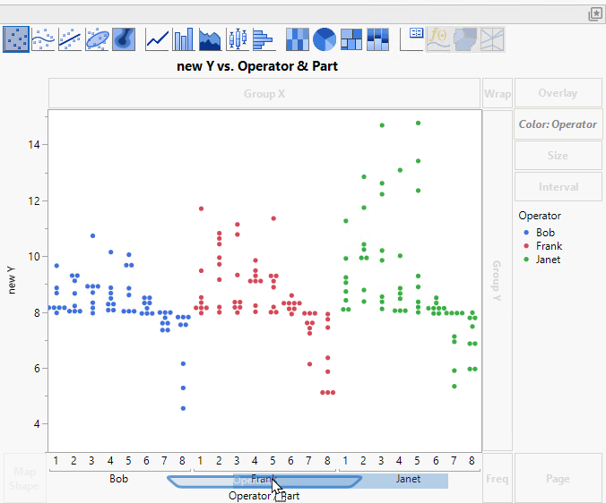

5. Drag Operator to the Color zone.
The new Y values are colored by Operator, shown in the legend at the right side of the graph. It appears that Janet might be measuring higher values than the other two operators on most parts. But the Operator effect is not easy to visualize, so you create a separate Operator axis.
6. Select Operator and drag it beneath Part in the X zone.
The label Operator/Part appears, which indicates that Part is associated with the topmost axis, and Operator is associated with the lower axis.
Figure 3.17 Drag Operator to Add a Second Axis

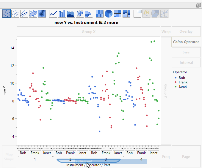

7. Select Instrument and drag it beneath Operator/Part in the X zone.
The label Instrument/Operator/Part appears, which indicates that a third axis for Instrument has been added beneath the Operator axis.
Figure 3.18 Drag Instrument to Add a Third Axis
It is clear that Instrument 2 leads to much more consistent measurements than the other three instruments. For Instrument 2, there is comparatively little variation between or within operators.

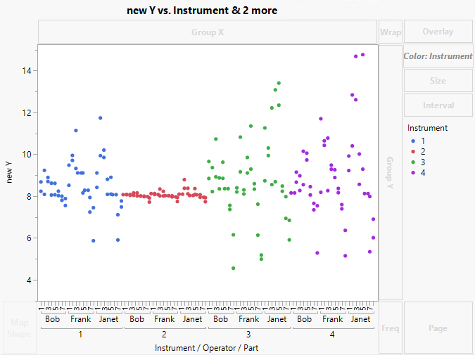

8. Select Instrument and drag it to the Color zone.
Figure 3.19 Three Nested Axes
Three Nested Axes
Now the new Y values are colored by Instrument, and it is easy to see Instrument differences.
By nesting the axes for the three factors in the study, you can get a visual understanding of the variation because of the factors.
