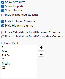

Figure 15.12 Columns Manager Preferences
Table 15.11 Preferences on the Columns Manager Page
Preference
Description
Show Attributes
Displays column attributes. This option is selected by default.
Show Properties
Displays column properties. This option is selected by default.
Show Statistics
Displays summary statistics for each column that includes Min, Max, N Missing, N Unique, a Distribution graph, and All Integers. Character columns have only a Distribution and N Unique. This option is selected by default.
Include Extended Statistics
Displays the statistics that are specified by the Extended Stats field in addition to the base set of summary statistics.
Hide Excluded Columns
Hides columns that have the excluded flag. This option is selected by default.
Hide Hidden Columns
Hides columns that have the hidden flag. This option is selected by default.
Force Calculations for All Numeric Columns
Specifies whether to calculate all numeric statistics for all numeric columns. This option is deselected by default.
When the option is selected, Columns Manager calculates the following statistics:
• For Continuous columns: N Unique
• For Nominal columns: Min and Max
Force Calculations for All Categorical Columns
Specifies whether to calculate all categorical statistics for all categorical columns. This option is deselected by default.
• For Unstructured Text columns: N Missing and N Unique
• For None type columns: N Unique
Extended Stats
Specifies which statistics to display when the setting Include Extended Stats is selected.
