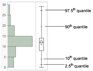

Use the Quantile Box Plot option in the Distribution platform to display specific quantiles from the Quantiles report. At a glance, you can see whether the distribution is symmetric. If the distribution is symmetric, the quantiles in the box plot are approximately equidistant from each other. For example, if the quantile marks are grouped closely at one end, but have greater spacing at the other end, the distribution is skewed toward the end with more spacing.
Figure 3.8 Quantile Box Plot
Quantile Box Plot
