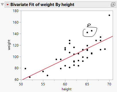

1. Click the lasso tool Image shown here in the toolbar.
2. Click and hold the lasso tool in a plot.
Note: To keep all points selected as you drag the lasso around several sets of points, press Shift before you click in the plot.
3. Drag the lasso around any set of points.
Figure 9.32 Using the Lasso Tool
4. Release the mouse.
JMP automatically closes the lasso and highlights the points within the enclosed area.
