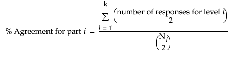

In the Gauge Attribute chart that plots all X, Grouping variables on the horizontal axis, the percent Agreement is calculated as follows:
Equation shown here

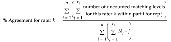

In the Gauge Attribute chart that plots all Y, Response variables on the horizontal axis, the percent Agreement is calculated as follows:
Equation shown here
where
n = number of parts (grouping variables)
ri = number of reps for part i (i = 1,...,n)
m = number of raters
k = number of levels
Ni = m × ri. Number of ratings on part i (i = 1,...,n). This includes responses for all raters, and repeat ratings on a part. For example, if part i is measured 3 times by each of 3 raters, then Ni is 3 × 3 = 9.
