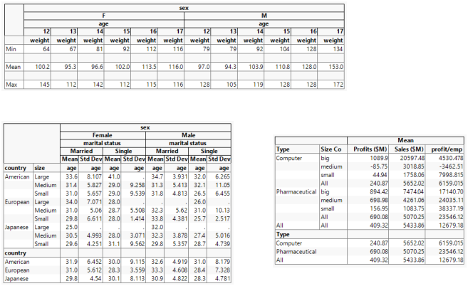

The Tabulate platform report consists of one or more column tables concatenated side by side, and one or more row tables concatenated top to bottom. The output might have only a column table or a row table.
Figure 9.10 Tabulate Output
Tabulate Output
Creating a table interactively is an iterative process.
• Click the items (columns or statistics) from the appropriate list, and drag them into the drop zone (for rows or columns). See Edit Tables, and Column and Row Tables.
• Add to the table by repeating the drag and drop process. The table updates to reflect the latest addition. If there are already column headings or row labels, you can decide where the addition goes relative to the existing items.
