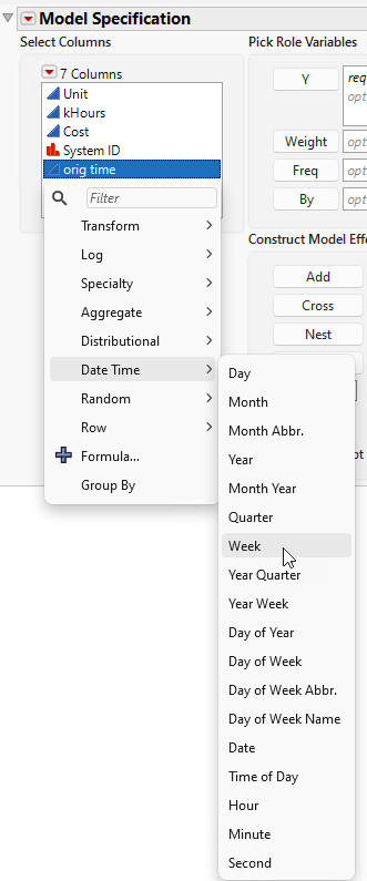

Each launch window in JMP enables you to create one or more temporary transform columns for use in performing analyses. These transform columns are not part of the source data table and can be used only within the context of the current launch window. Transform columns use formulas or calculations to define the column values. Closing the launch window deletes any transform columns.
Each column listed in the Select Columns pane of the launch window includes an icon that represents the column’s modeling type (continuous, ordinal, or nominal) and the column name. Right-click a column name to create a transform column by using Transform, Character, Combine, Pairwise, Aggregate, Distributional, Date Time, Random, Row, Vector, or Formula to calculate the column’s values.
Right-click options depend on the selected column’s data type and number of columns that are selected.
Figure 4.44 Example of Transform Column Menu

Date Time Menu
For column values that contain date or time values, select a function from the Date Time menu to create a transform column that contains values that are calculated from the selected column.
The following functions are included in the menu:
Day
Returns the day of the month for the date in the selected column.
Month
Returns the month number for the date in the selected column.
Month Abbr.
Returns the abbreviated month for the date in the selected column.
Year
Returns the year for the date in the selected column.
Month Year
Returns the month number and year for the date in the selected column.
Quarter
Returns the year’s quarter (1, 2, 3, or 4) for the date in the selected column
Week
Returns the number of the week in the year for the date in the selected column.
Year Quarter
Returns the year and the year’s quarter (1, 2, 3, or 4) for the date in the selected column.
Year Week
Returns a string that represents the ISO-8601 week of year format (for example, June 12, 2013 results in “2013W24”).
Day of Year
Returns the day of the year for the date in the selected column.
Day of Week
Returns the day of the week for the date in the selected column.
Day of Week Abbr.
Returns the abbreviated day of the week for the date in the selected column.
Day of Week Name
Returns the full day of the week for the date in the selected column.
Date
Returns the month, day, and year for the date in the selected column.
Time of Day
Returns the time for the date in the selected column.
Hour
Returns the hour part of the date in the selected column.
Minute
Returns the minute part of the date in the selected column.
Second
Returns the seconds part of the date in the selected column.
