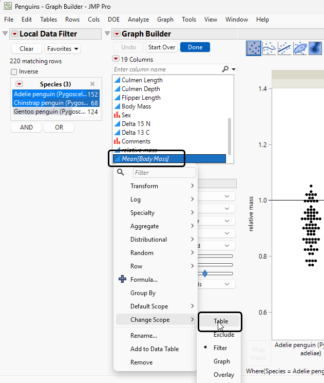

The resulting graph displays the average body mass of the rows that were not filtered out. To change the scope to use all rows from the table, right-click the Mean[Body Mass] column and select Change Scope > Table.
Figure 4.45 Change Scope
Change Scope
