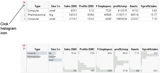

Instant Histograms
You can view a histogram instantly by clicking the histogram icon in the column header. Histograms appear below the column header.
Figure 4.3 Instant Histograms

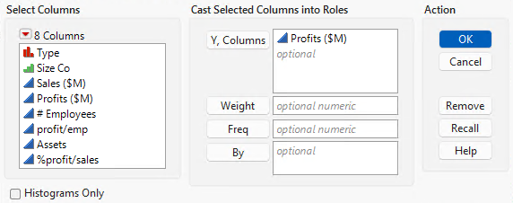

2. Select Analyze > Distribution.
3. Select Profits ($M) and click Y, Columns.
Figure 4.4 Distribution Window for Profits ($M)
4. Click OK.

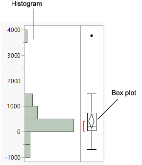

Figure 4.5 Histogram of Profits ($M)
Interpret the Histogram
The histogram provides these answers:
• Most companies’ profits are between $-1000 and $1500.
All the bars except for one are in this range. Also, more companies’ profits range from $0 to $500 than any other range. The bar that represents that range is much longer than the others.
• The average profit is slightly below $500.
The middle of the diamond in the box plot indicates the mean value. In this case, the mean is slightly lower than the $500 mark.
• One company has significantly higher profits than the others and might be an outlier. An outlier is a data point that is separated from the general pattern of the other data points.
This outlier is represented by a single, short bar at the top of the histogram. The bar represents a small group (in this case, a single company), and it is widely separated from the rest of the histogram bars.
In addition to the histogram, this report includes the following information:
• The box plot, which is another graphical summary of the data. For detailed information about the box plot, see “Box Plot” in Essential Graphing.
• Quantiles and Summary Statistics reports. These reports are discussed in “Analyze Distributions”.
