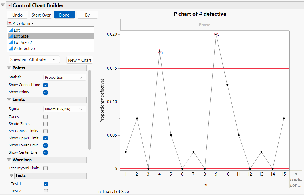

In this example, an engineer has data relating to the production of steel washers. They want to identify and triage the proportion of washers in each lot that are defective, based on static control chart limits. Follow these steps:
Set Static Control Limits
In JMP, select Help > Sample Data Folder and open Quality Control/Washers.jmp.
Right-click the # defective column and select Column Properties > Control Limits.
Change XBar to P.
For Avg, enter 0.0055.
5.
For LCL, enter 0.
6.
For UCL, enter 0.015.
7.
For Subgroup Size, enter 400.
Figure 1.2 Control Limits in JMP
8.
Click OK.
Create a Control Chart
In JMP, select Analyze > Quality and Process > Control Chart > P Control Chart.
Select # defective and click Y, n Defective.
Select Lot and click Subgroup.
Select Lot Size and click n Trials.
5.
Click OK.
6.
Click the red triangle next to Control Chart Builder and select Show Control Panel.
7.
Open Warnings > Tests and click Test 1.
Figure 1.3 Control Chart in JMP
8.
Click Done.
The P-chart shows the proportion of defective washers per lot. You can see that there are two points beyond the control chart limits.

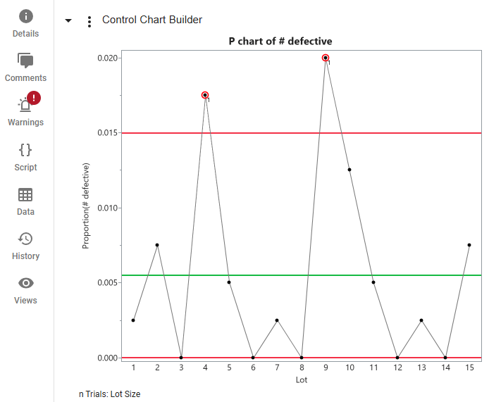

Publish a Control Chart
In JMP, with the control chart report open, select File > Publish > Publish Reports to JMP Live.
Follow the steps in the wizard to publish the report, and then open the report in JMP Live.
Figure 1.4 Control Chart Post in JMP Live
The control chart warnings are circled in red in the graph, and the Warnings icon appears at left with a red exclamation mark.

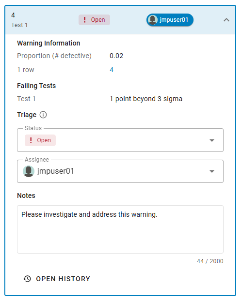

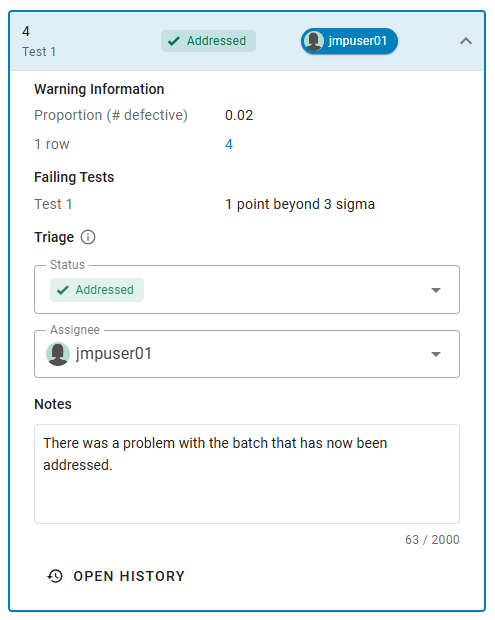

Assign Warnings for Triage
Open a control chart post in JMP Live.
Click a warning in the control chart.
The Warnings panel opens with the details for that warning. See Figure 1.5.
Tip: To assign multiple warnings to a single person or group, drag a box around the warnings in the control chart, and then right-click and select Triage.
Click Image shown here next to Assignee to assign the warning to a person or group who has access to the post. Or, click Assign to me.
(Optional) Enter any relevant notes about the warning for the assignee.
Tips:
You can @mention someone in the notes and they get a notification.
You can use markdown syntax for formatting, such as * text for bullets, 1. text for numbered lists, *italics*, and **bold**.
5.
Click Save.
Figure 1.5 Assigning a Warning in JMP Live
The assignee gets notifications in JMP Live and by email. For details about notifications, see Manage Warning Notifications.

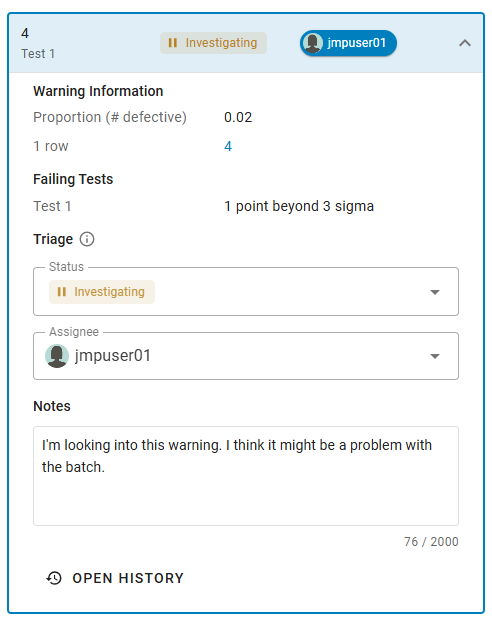

Triage Warnings
Open the control chart post in JMP Live.
Tip: To triage multiple warnings at once, drag a box around the warnings in the control chart, and then right-click and select Triage. Using this method, all selected warnings have the same status after triaging.
Change the status to Investigating or Addressed.
(Optional) Enter any relevant notes about the investigation or fix.
5.
Click Save.
Figure 1.6 Triaging a Warning in JMP Live
Review Triaged Warnings
Click Warnings.
Click Image shown here to see the details for a warning.
Verify that the warning is Addressed and review any notes.
Figure 1.7 Verifying an Addressed Warning in JMP Live
5.
(Optional) Click OPEN HISTORY to see or download the triage history for the warning.

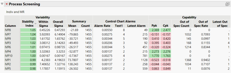

In the data table, select Analyze > Quality and Process > Process Screening.
6.
Click Process Variables. This assigns the 10 columns that you selected as the process variables.
Notice that the Control Chart Type is set to Indiv and MR (Individual and Moving Range charts).
7.
Click OK.
Figure 1.8 Process Screening Summary Report in JMP
This report contains a table of results for each process. The results are sorted by the stability index, which measures the stability of a process. A stable process has a stability index near 1. Higher values indicate a less stable process. (The sorting is indicated by the caret next to Stability Index.)

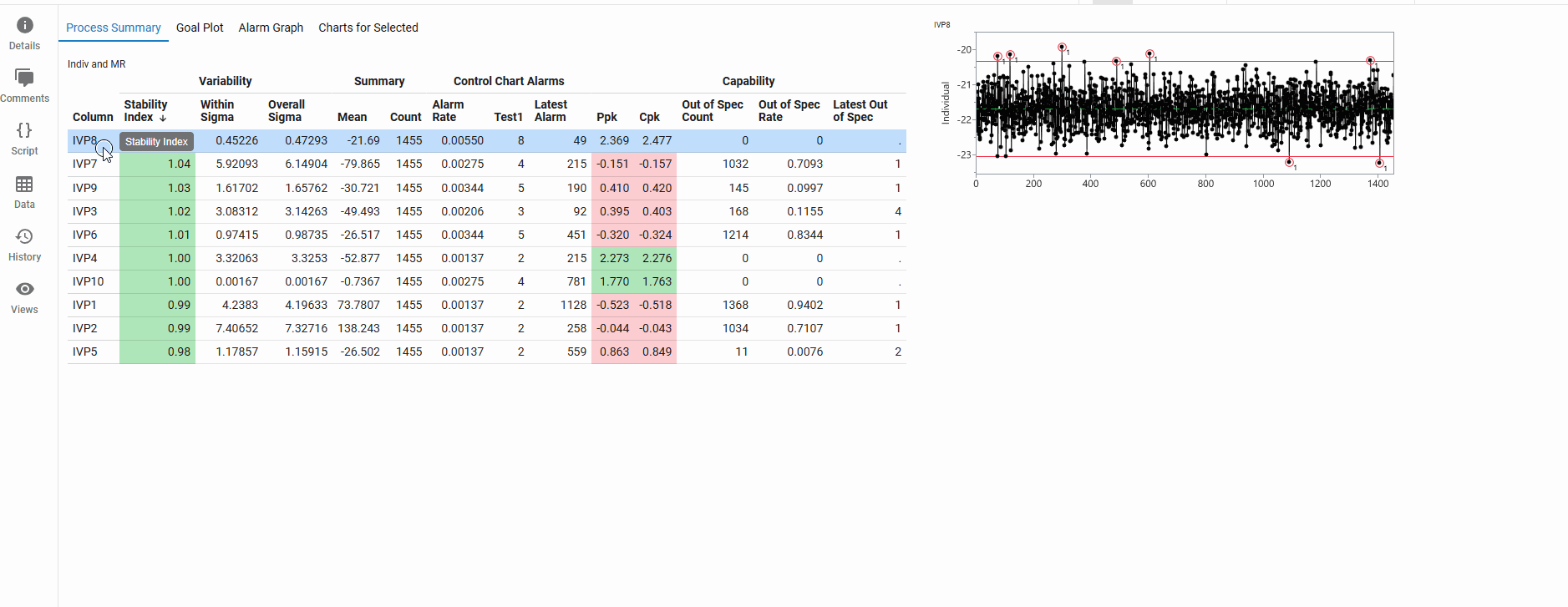

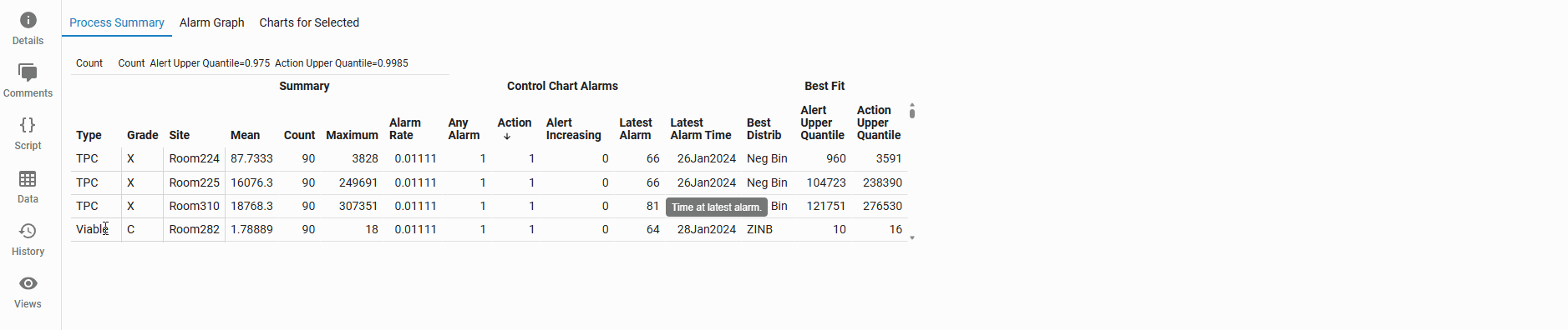

Figure 1.9 Process Summary Post in JMP Live
Note the following about this post:
Additional charts (in this example, Goal Plot, Alarm Graph, and Charts for Selected) appear in tabs. The Charts for Selected tab contains charts for the rows that you selected in JMP prior to publishing to JMP Live.
Click columns in tables or points in graphs to show their individual control charts at right.

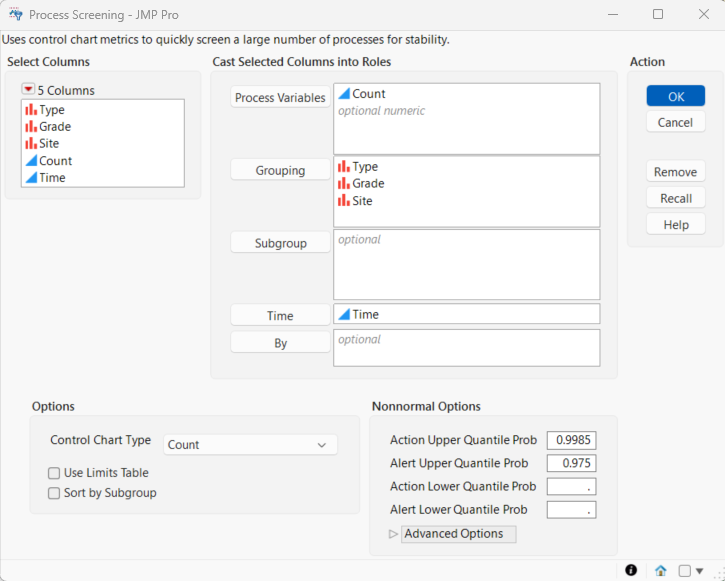

In JMP, select Help > Sample Data Folder and open Quality Control/Environmental Monitor Sim.jmp.
Select Analyze > Quality and Process > Process Screening.
Select Count and click Process Variables.
Select Type, Grade, and Site and click Grouping.
5.
Select Time and click Time.
6.
Set the Control Chart Type to Count.
Figure 1.10 Process Screening Launch Window in JMP
7.
Click OK.

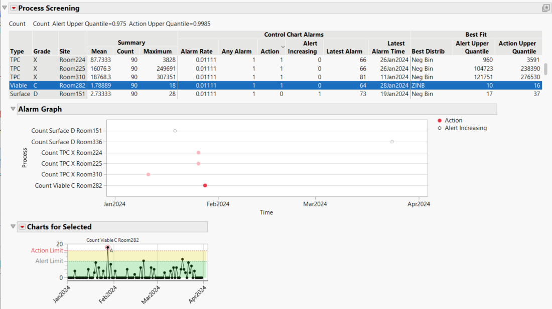

8.
In the Summary table, select the fourth row with the type Viable.
9.
Click the Process Screening red triangle and select the following:
Show Charts for Selected
Alarm Graph
10.
Click the Charts for Selected red triangle and select the following:
Show Markers
Show Zones
Circle Alarm Points
Figure 1.11 Process Screening Report in JMP
The Summary table (shown partially) sorts each process by the Action count.
Tip: To resize the Summary table, click and drag from the bottom of the table.
For the process that you selected:
There was an action alarm in late January 2024. The action limit (Action Upper Quantile) was set to 16, which is the 99.85% quantile of the fitted distribution.
The alarm graph shows six processes with alarms by date, including two that are near the same time as the selected process. This could be an indication of possible cross-contamination between monitoring sites.

In the Summary table, select the 4th row with the type Viable.
Figure 1.12 Process Summary Post in JMP Live
Additional charts (in this example, Alarm Graph, and Charts for Selected) appear in tabs. The Charts for Selected tab contains charts for the rows that you selected in JMP prior to publishing to JMP Live.
