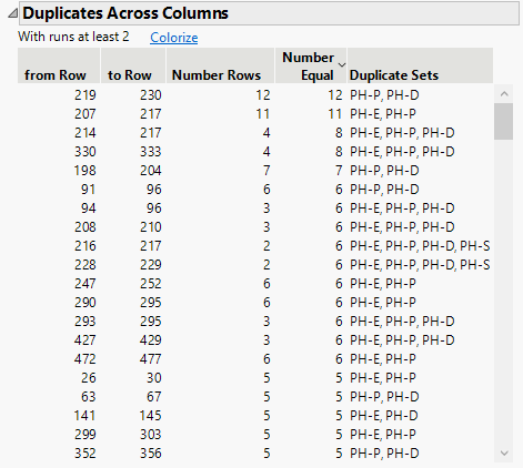

5. In the Control Panel, under Across Columns, click the box next to Duplicates Across Columns.
Figure 24.5 Duplicates Across Columns Report
The Duplicates Across Columns report shows a long list of duplicate columns. However, the minimum run size is 2 and there are many small runs in the list. You want to focus on the larger runs of at least 10.

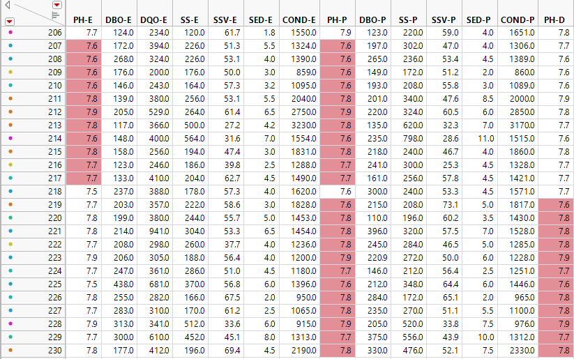

7. Click Colorize in the Duplicates Across Columns Report.
Figure 24.7 Colorized Water Treatments.jmp Data Table
The Colorize feature colors the cells in the original data table that correspond to the duplicate sets in the report.
