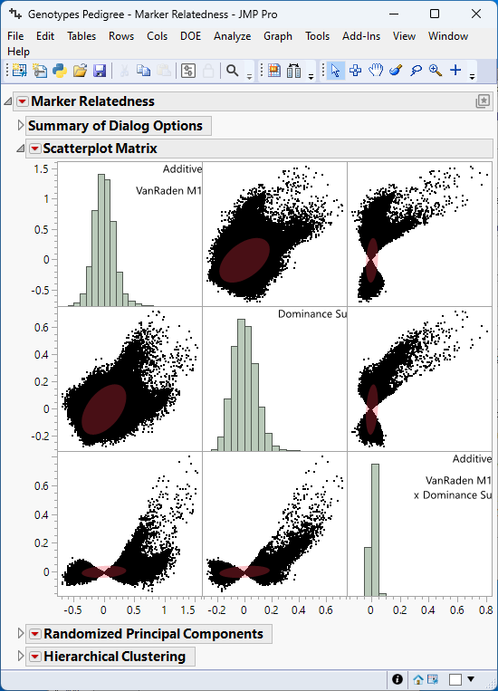

The Marker Relatedness report is generated as shown in Figure 5.5.
Figure 5.5 Example of the Marker Relatedness Platform
In this example, instead of a simple distribution, the scatterplot matrix shows a matrix plot of additive effects, dominance effects, and the interaction of the two. The three distributions show the interaction of Additive effects with themselves (upper left), Dominance effects with themselves (center), and epistatic effects with themselves (lower right). The remaining blocks represent correlations between each pair of the three types of interactions. The absence of strong correlation among relatedness measures (additive, dominance, and epistasis) shows that each measure is capturing distinct information from the markers, which is desirable.

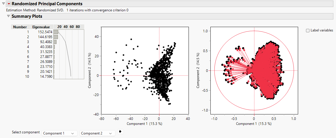

Figure 5.6 Principal Components Analysis

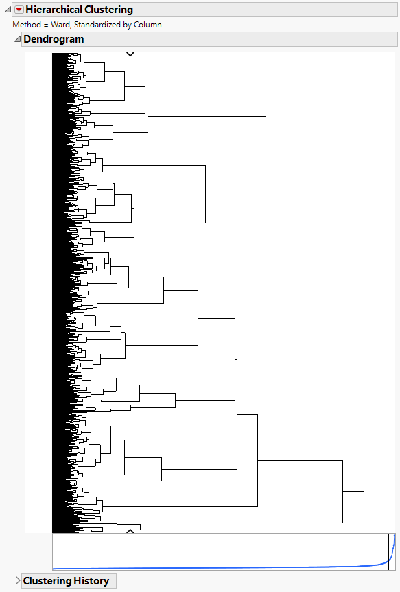

Although, principal components plots do not show the presence of clearly separated groups of individuals, the cluster analysis does show the presence of a separation of groups of individuals.
Figure 5.7 Cluster Analysis
Cluster Analysis

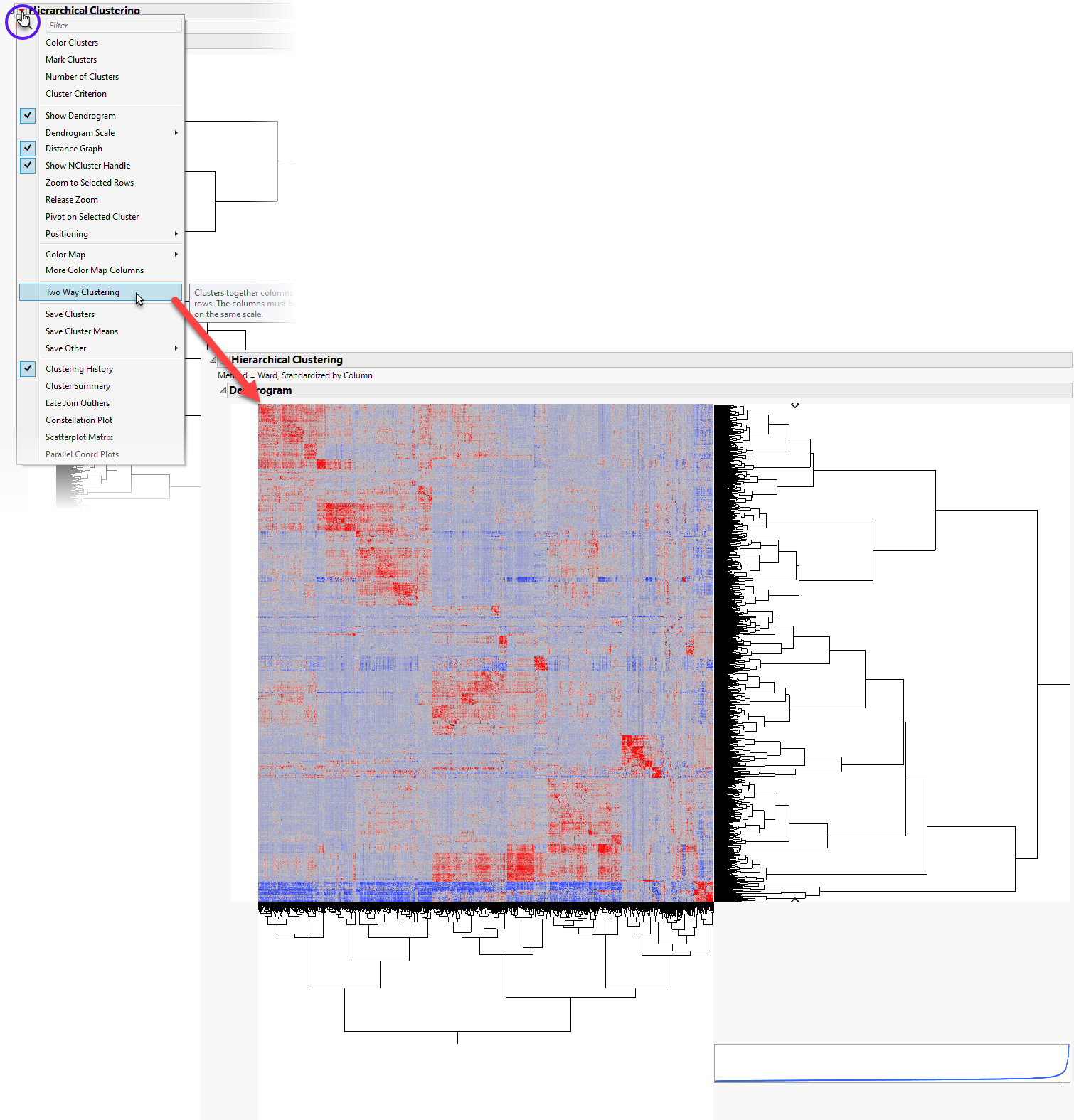

This separation can be more clearly seen when Two Way Clustering is turned on, as shown in Figure 5.8.
Figure 5.8 Example of the Marker Relatedness Platform: Two Way Clustering
The heat map plot shows evidence of the presence of groups of individuals (in red) that are clearly highly related with each other.
