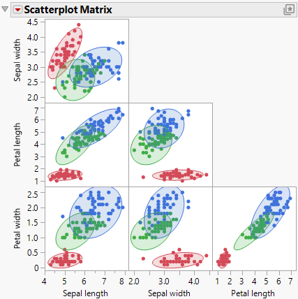

9. Perform the Scatterplot Matrix analysis.
Follow the instructions in Example That Uses a Grouping Variable, but use Cluster as the grouping variable.
Figure 6.12 Example of a Scatterplot Matrix with a Cluster Variable
