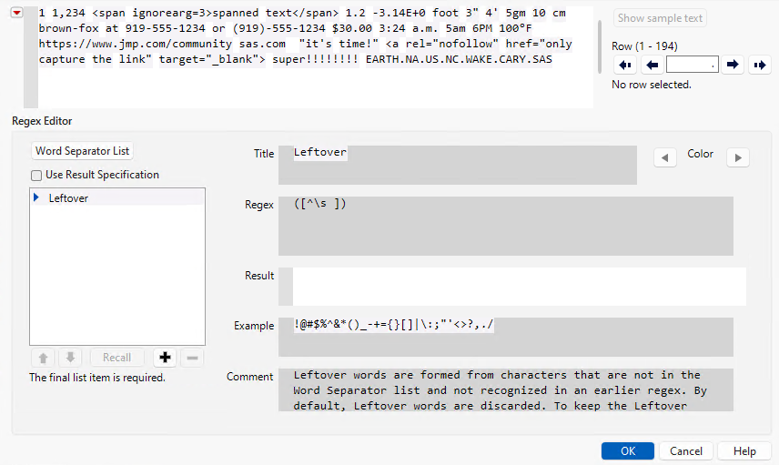

Figure 4.36 Regular Expressions Editor

6. Next to Title, enter Cat.
7. Next to Regex, type (cat(?:s?))([\s\.]).
This expression finds “cat”, optionally followed by “s”, with either a space or period afterward.

10. Next to Title, enter Dog.
11. Next to Regex, type (dog(?:s?))([\s\.]).

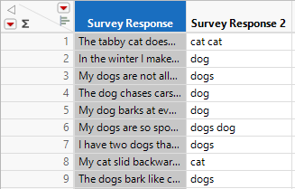

Figure 4.37 Data Table with New Columns
The Use Result Specification option in the Regular Expressions Editor gives you control over which matched text appears in the new column:
If you do not select Use Result Specification (the default setting), the result in the new column is whatever is produced by the regular expression in the right side of the editor.
If you select Use Result Specification, the result in the new column is whatever is produced by the Result expression in the right side of the editor. If your regular expression is Air(port), then the new column contains the word port when found in the original column.
