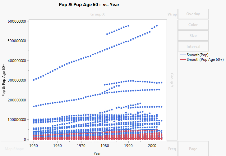

Figure 3.14 Pop and Pop Age 60+ Merged
To make the Pop Age 60+ values more visible, calculate yearly means and then add a second Y axis.

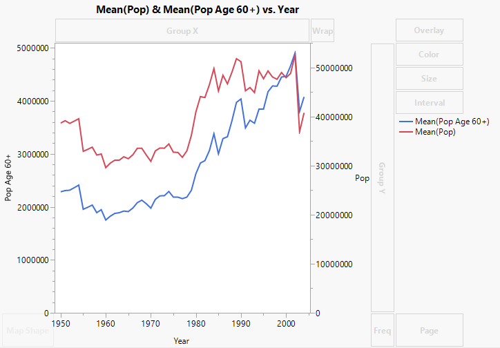

Figure 3.15 Second Y Axis Added
Second Y Axis Added
An axis for Pop is added on the right side of the graph, and the axes rescale to show both sets of values. You can now see relationships between the two measures. For example, both measures began to decrease in 2002.
