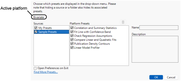

To access the Customize Menu window, select the Platform Presets button Image shown here and then select Customize Menu.
Figure 10.6 The Customize Menu Window
Note that the Customize Menu window displays only the presets that are compatible with the current platform. If you want to see and customize all the presets, use "Open Preferences on Exit”, which is explained later.
