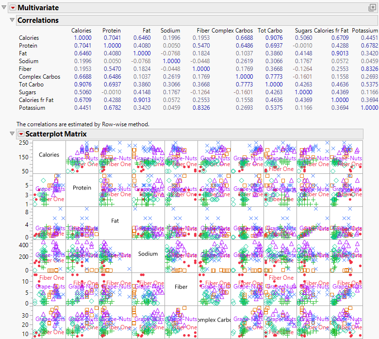

2. Select Analyze > Multivariate Methods > Multivariate.
3. Select the columns from Calories through Potassium, click Y, Columns, and then click OK.
Figure 10.3 The Initial Multivariate Report Window

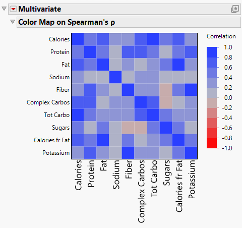

4. Click the Multivariate red triangle and select Color Maps > Color Map on Spearman’s ρ.
5. Click the Multivariate red triangle and deselect Correlations Multivariate and Scatterplot Matrix.
6. Double-click the X Axis to open X Axis Settings and click the Font button.
7. Set the Size to 14 and click OK.
8. In X Axis Settings, click OK to apply your changes.
Figure 10.4 The Customized Report Window

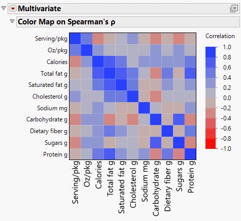

4. In the Multivariate menu bar, click the Platform Presets button Image shown here and then select My Presets > Nonparametric Color Map.
Figure 10.5 The Report Window with the New Platform Preset Applied
