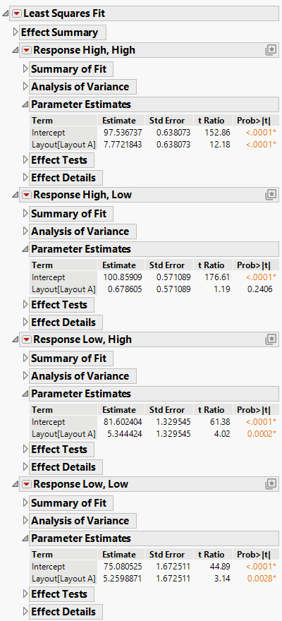

3. Select Analyze > Fit Model.
Since there is a Model script in the data table, the Model Specification window is already filled in. Note that the columns High, High through Low, Low are entered as Y and that Layout is the single model effect.
4. Click Run.
Figure 8.39 Four Univariate Models
The report indicates that Layout has a statistically significant effect for all quadrants except the High, Low quadrant.

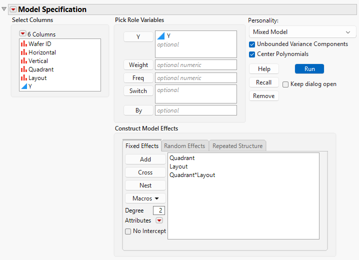

5. Select Quadrant and Layout from the Select Columns list and click Macros > Full Factorial.
This model specification enables you to explore the effect of Layout on the repeated measurements as well as the possible interaction of Layout with Quadrant.
Figure 8.40 Fit Model Launch Window That Shows Completed Fixed Effects Tab

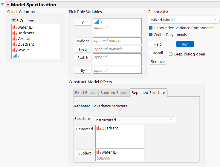

6. Select the Repeated Structure tab.
7. Select Unstructured from the Structure list.
8. Select Quadrant and click Repeated.
9. Select Wafer ID and click Subject.
Figure 8.41 Fit Model Launch Window That Shows Repeated Structure Tab
10. Click Run.

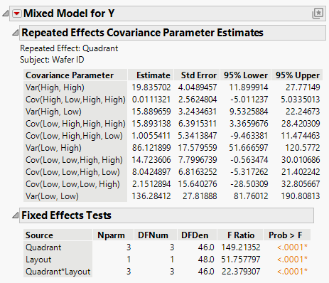

Figure 8.42 Mixed Model Report with Fixed Effects Parameter Estimates Report Closed
The Repeated Effects Covariance Parameter Estimates report gives the estimated variances and covariances for the four responses. Note that the confidence interval for the covariance of Low, High with High, High does not include zero. This suggests that there is a positive covariance between measurements in these two quadrants. This is information that the Mixed Model analysis uses and that is not available when the responses are modeled independently.
The Fixed Effects Tests report indicates that there is a significant Quandrant by Layout interaction.

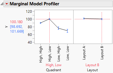

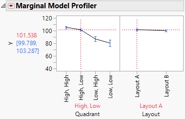

1. Click the Mixed Model red triangle and select Marginal Model Inference > Profiler.
2. In the Profiler plot, compare the predicted values for Y across the quadrants by first setting the vertical red dotted line at Layout A and then at Layout B.
Figure 8.43 Profile for Quadrant for Layout A
Figure 8.44 Profile for Quadrant for Layout B
The differences in the profiles at each setting of Layout give you insight into the significant interaction. It appears that the interaction is partially driven by the differences for the High, High quadrant.

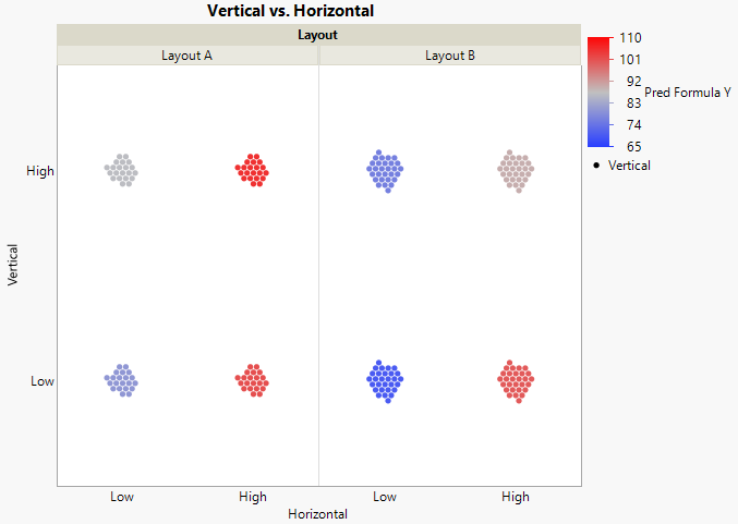

Use Graph Builder to explore the nature of the interaction.
1. Click the Mixed Model red triangle and select Save Columns > Prediction Formula.
The prediction formula is saved to the data table in the column Pred Formula Y.
3. Drag Horizontal to the X zone.
4. Drag Vertical to the Y zone.
5. Drag Pred Formula Y to the Color zone.
6. Drag Layout to the Wrap zone.
7. Click Done to hide the control panel.
Figure 8.45 Completed Graph Builder Plot
The plot shows the predicted differences for the eight Layout and Quadrant combinations using a color intensity scale. The predicted values for the High, Low quadrant are in the lower right. The color gradient shows relatively little difference for these predicted values. Other differences are clearly indicated.
