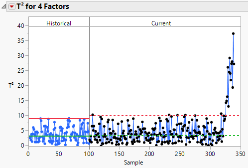

Figure 12.10 T2 ChartĀ
T2 Chart
The blue data points represent the historical data. The black data points are data points collected after the control chart was established. The process experienced an upset that begins around sample number 326.
6. Hover over the sample data points that are above the upper control limit to view contribution plots.

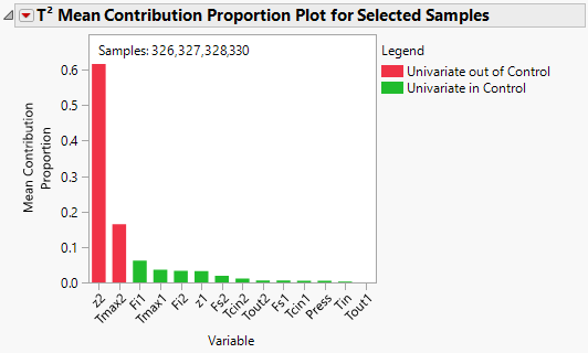

7. Select the first cluster of data points above the upper control limit. Click the T2 for 4 Factors red triangle and select Mean Contribution Proportion Plot for Selected Samples.
8. Click the red triangle next to T2 Mean Contribution Proportion Plot for Selected Samples and select Sort Bars.
Figure 12.11 Mean Contribution Proportion PlotĀ
Notice that the contributions plot is in terms of the PLS model input variables. It appears that z2 and Tmax2 are causing the process upset. Tmax2 and z2 are related. Tmax2 is a reactor temperature and z2 is the location of the Tmax2 temperature.
