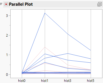

Figure 7.3 Trimeth Values Highlighted
Notice the following traits about the histamine levels for dogs given trimeth:
For four of the dogs, the histamine level remains relatively stable across time.
Three dogs had histamine levels that spiked at 1 minute, with one dog showing a large spike. One dog's histamine level spiked at 3 minutes.
You might investigate this finding further to determine why the histamine levels were different.
