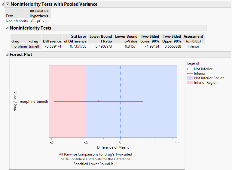

Figure 6.27 Example of a Test for Noninferiority
The observed difference in the response for the two drugs was -0.639 units. The lower bound on the confidence interval of -1.93 falls below the lower noninferiority limit of -1.0. You do not conclude that the alternative drug is not inferior to the standard drug.
