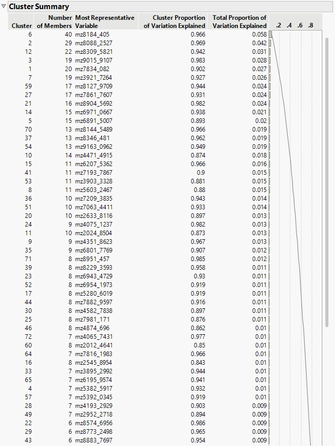

Figure 17.6 Cluster Summary (Partial Report)

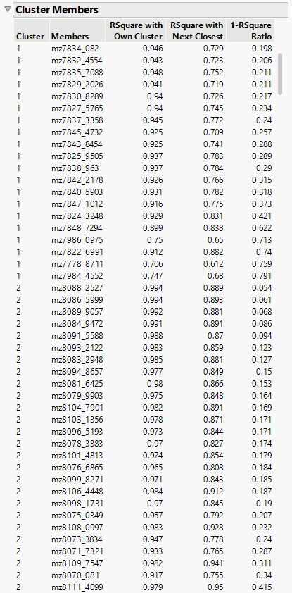

Figure 17.7 Cluster Members (Partial Report)
The Cluster Summary and Cluster Members reports show that the variables are clustered into 72 groups, so there are 72 Cluster Component variables. These 72 variables are also added to the data table as a new column group of formula columns.

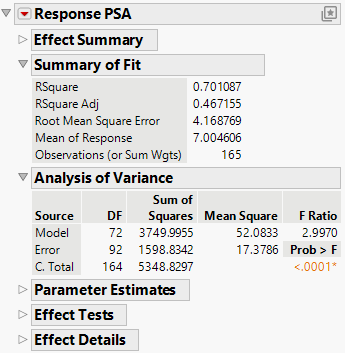

Because the number of predictors (667) exceeds the number of observations (165) in the original data, a standard least squares model cannot be fit. However, by applying variable clustering as a dimension-reduction technique, the data are condensed into 72 Cluster Components, which makes it possible to fit a least squares model.

5. Click Run.
Figure 17.8 Fit Least Squares Report for Model with Cluster Components as Predictors
The Least Squares report shows that the model that uses the 72 Cluster Components as predictors performs reasonably well (p-value < 0.0001) with an adjusted RSquare of 0.467. These values indicate that the predictors provide explanatory power for the response. Reducing 667 variables to 72 components results in some loss of information, but the model remains effective and demonstrates that variable clustering is a valuable technique for dimension reduction in high-dimensional predictive modeling.
