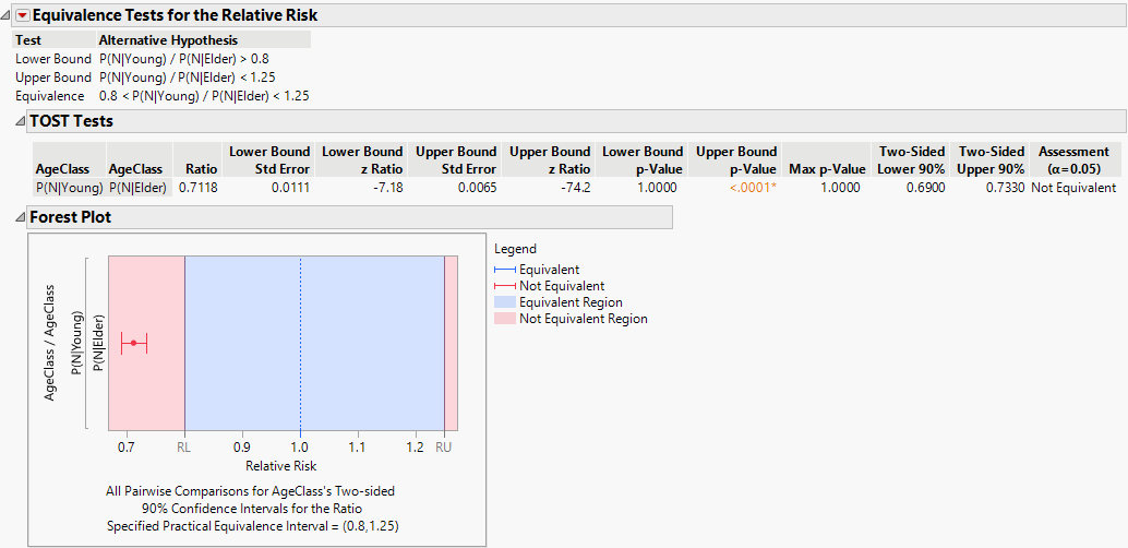

6. Click the Contingency Analysis red triangle menu and select Equivalence Tests > Relative Risk.
7. In the Margin and Alpha panel, type 0.8 for the Ratio.
8. In the X Category of Interest panel, select Young.
9. Click OK.
Figure 7.17 Equivalence Test for Relative RiskĀ
The relative risk of not filing a claim for young drivers versus elder drivers is 0.7118. From the two one-sided tests (TOST) equivalence test procedure, you cannot conclude that these groups are equivalent in their rates of filing claims.
