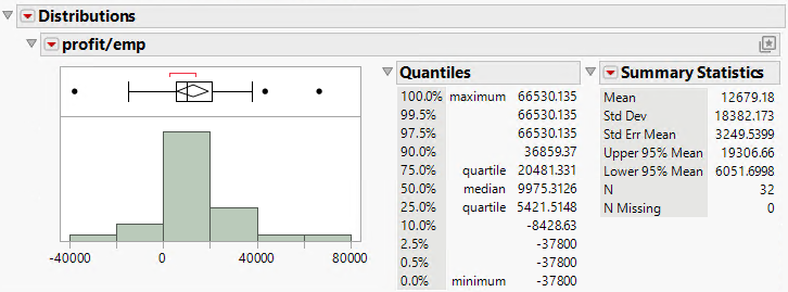

2. Select Analyze > Distribution.
3. Select profit/emp and click Y, Columns.
4. Click OK.
5. Click the profit/emp red triangle and select Display Options > Horizontal Layout.
Figure 3.16 Distribution of profit/emp

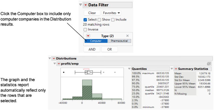

6. Turn on Automatic Recalc by selecting Redo > Automatic Recalc from the Distributions red triangle.
When this option is on, every change that you make (for example, hiding or excluding points) causes your report window to automatically update.
7. In the data table, select Rows > Data Filter.
8. Select Type and click the Image shown here button.
9. Make sure that Select is selected.
10. To filter out the Pharmaceutical companies from the Distribution results and include only the Computer companies, click the Computer box in the Data Filter window.
The Distribution results update to only include Computer companies.
Figure 3.17 Filter for Computer Companies
Conversely, to change the Distribution results to include only the Pharmaceutical companies, click the Pharmaceutical box on the Data Filter window.
