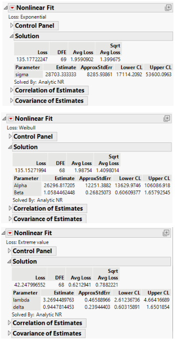

Exponential, Weibull, and Extreme-Value Loss Function
You can use the Nonlinear platform to fit exponential, Weibull, and extreme value loss functions to failure time data. The data in this example are from a study of 70 diesel fans that accumulated a total of over 300 thousand hours in service. The fans were placed in service at different times. The response is failure time of the fans or run time at censoring.
1. Select Help > Sample Data Folder and open Reliability/Fan.jmp.
Tip: To view the formulas for the loss functions, in the Fan.jmp data table, right-click the Exponential, Weibull, and Extreme value columns and select Formula.
2. Select Analyze > Specialized Modeling > Nonlinear.
3. Select Exponential and click Loss.
4. Click OK.
5. Make sure that the Loss is Neg LogLikelihood check box is selected.
6. Click Go.
7. Click Confidence Limits.
8. Repeat these steps, but select Weibull and Extreme value instead of Exponential.
Figure 15.28 Nonlinear Fit ResultsĀ
