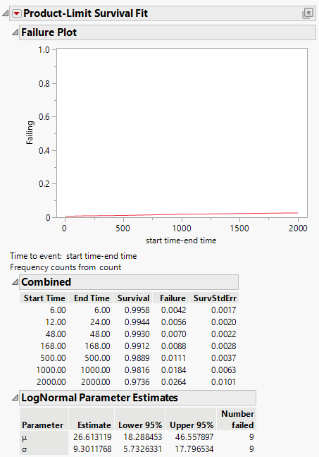

Figure 15.14 Interval Censoring Output
The resulting Turnbull estimates are shown. Turnbull estimates might have gaps in time where the survival probability is not estimable. In this example, such gaps occur between 6 and 12, 24 and 48, 48 and 168, and so on.
At this point, select a distribution to see its fitted estimates —in this case, a Lognormal distribution is fit. Notice that the failure plot shows very small failure rates for these data.
