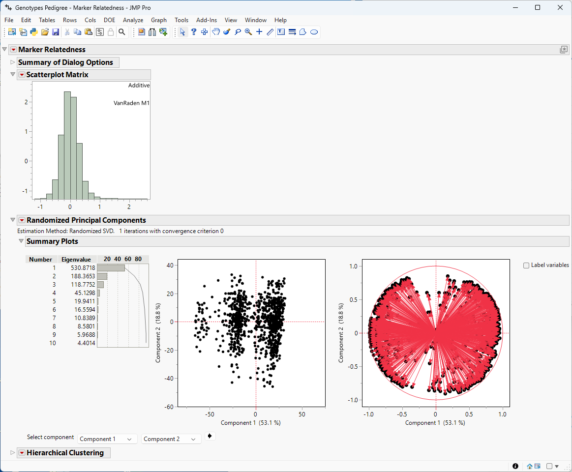

The Marker Relatedness report is generated as shown in Figure 5.2.
Figure 5.2 Relatedness of the Markers
The Marker Relatedness report was run once for each sex (M and F) and contains the following information for each sex. The results are shown for one sex only.
The Summary of Dialog Options summarizes the selections made on the platform and the time it took for the simulation to run.
The Scatterplot Matrix display shows the histogram (and correlation plots when estimating epistasis). A histogram skewed to the right (high values) indicates that most individuals have strong genetic similarity. A histogram skewed to the left (low values) indicates that most individuals have weak genetic similarity.
The Principal Components plots show the clusters of individuals grouped by their relatedness. In the example shown, the samples do not appear to form definite groups.

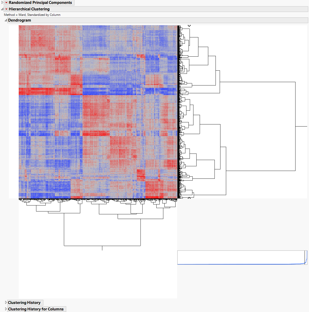

The Clustering plot is another way to view groups of related individuals. Click the Clustering red triangle and select Two Way Clustering to produce a heat map of relationship estimates among individuals (shown in Figure 5.3), which is useful to visualize the range of estimates graphically among all pairs of individuals.
Figure 5.3
Image shown here
