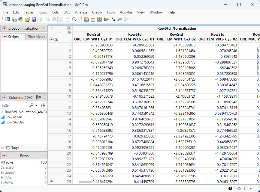

1. Open a suitable JMP table or another data set in JMP.
2. Select Analyze > Life Sciences > Normalization.
3. Select all of the data columns except the SPOT column and click Y, Columns.
4. Check the Create New Tables for Results check box.
5. Click OK.
Figure 8.1 Table That Contains the Normalized Data
