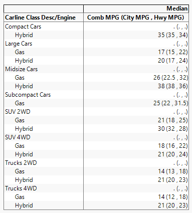

Figure 9.26 Tabulate Report with Packed ColumnsĀ
The median gas mileages for hybrid vehicles is higher in each vehicle class. For example, the combined gas mileage for hybrid large cars is 20, and the combined gas mileage for gas large cars is 17.
