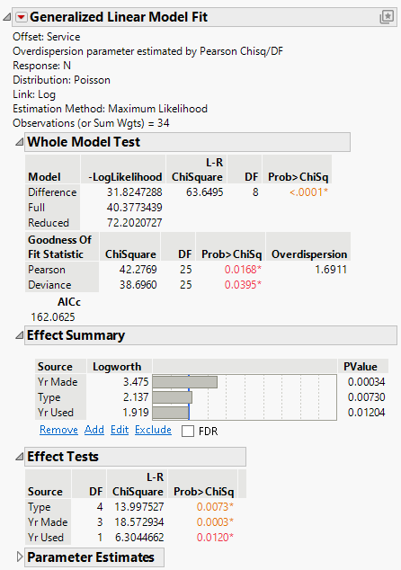

From the report, notice that all three effects (Type, Yr Made, Yr Used) are significant.
Figure 13.7 Partial Report for a Poisson with Offset Model
