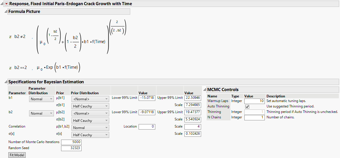

9. Click Go to Bayesian Estimation.
Figure 9.4 Initial Response Report
The initial response report contains a picture of the path definition formula and a panel for specifying priors for the hierarchical Bayes model. There are also options to control the Bayesian estimation procedure.

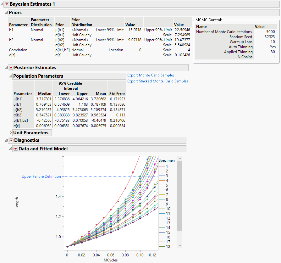

10. Click Fit Model.
Figure 9.5 Bayesian Estimates Report (Partial)
The Posterior Estimates report shows the results of the Markov chain Monte Carlo (MCMC) procedure. Use the buttons to the right of the table to view all the MCMC samples in a data table. The Diagnostics report shows the original data values along with curves for the fitted model.

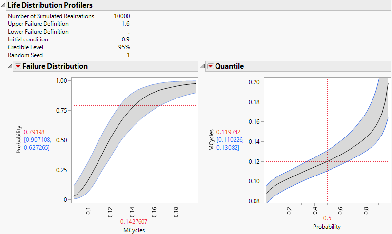

Use the Life Distribution Profilers report to estimate the number of cycles at which 50% of the crack sizes reach 1.6 inches.
11. In the Quantile profiler, type 0.50 for Probability.
Figure 9.6 Life Distribution Profilers
Note the Upper Failure Definition of 1.6 inches. This is the definition of a failure used in the Failure Distribution and Quantile profilers in the Life Distribution Profilers report. The Quantile profiler, at probability 0.50, shows that the estimated number of cycles at which 50% of the crack sizes reach 1.6 inches is 0.1197 with a 95% credible interval of 0.11 to 0.131.
