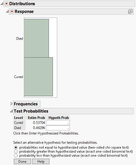

Initiate the Test Probabilities Report
1. Select Help > Sample Data Folder and open Penicillin.jmp.
2. Select Analyze > Distribution.
3. Select Response and click Y, Columns.
4. Click OK.
5. Click the Response red triangle and select Test Probabilities.
Figure 3.14 Test Probabilities Report Options for a Variable with Exactly Two LevelsĀ

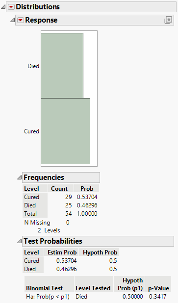

Generate the Test Probabilities Report
1. Type 0.5 in both Hypoth Prob fields.
2. Click the probability less than hypothesized value button.
3. Click Done.
Exact probabilities are calculated for the binomial test.
Figure 3.15 Examples of Test Probabilities Reports for a Variable with Exactly Two LevelsĀ
