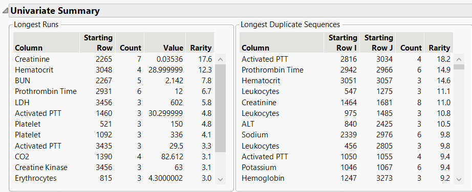

5. Click the gray disclosure icon next to Univariate Summary to open the Univariate Summary report.
Figure 24.2 Explore Patterns Univariate Summary ReportĀ
The Univariate Summary report summarizes the longest runs and longest duplicate sequences found across all of the columns. Each table is sorted by Rarity, a calculation of how likely the run or sequence is to occur by chance. The column with the highest rarity score for longest runs is Creatinine, whereas the column with the highest rarity score for longest duplicate sequences is Activated PTT. These columns are further examined in the Univariate Patterns Report.

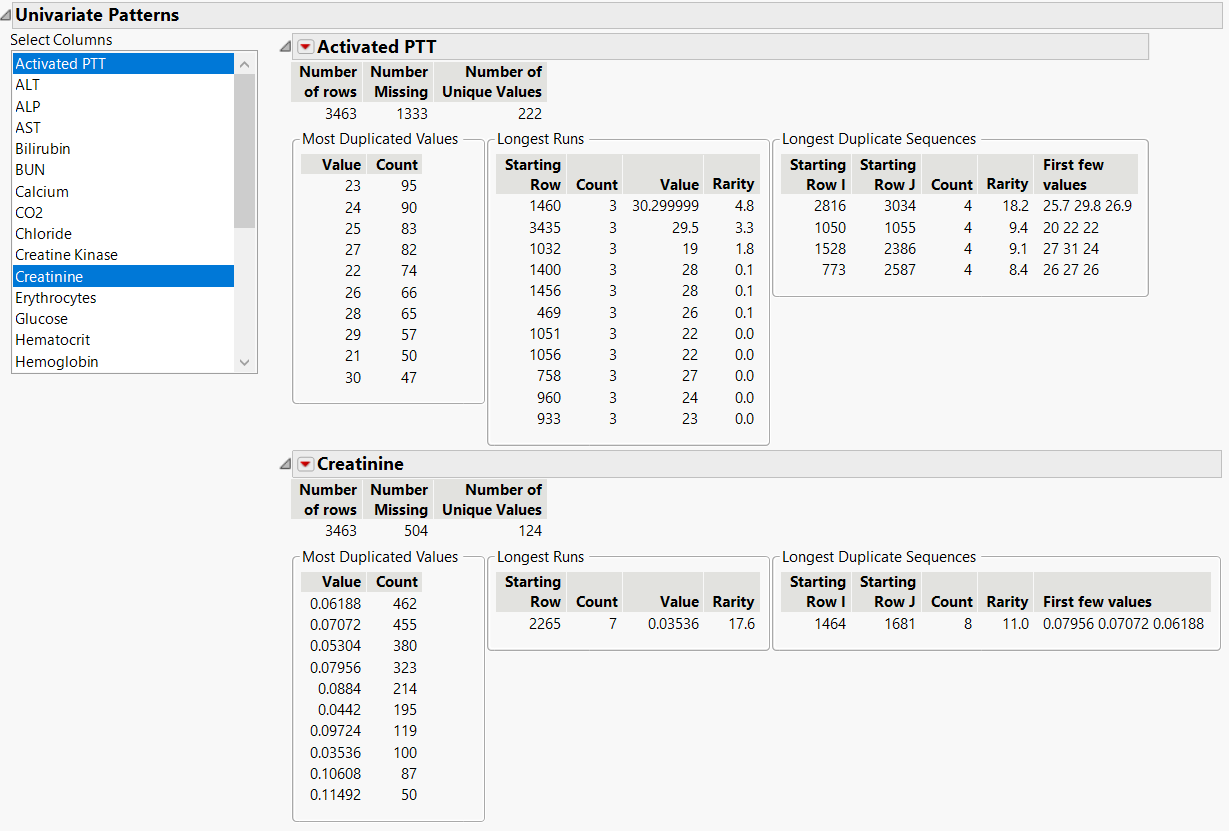

6. In the Univariate Patterns report, the report for the first column, Activated PTT, is shown initially. Press Ctrl and select Creatinine from the Select Columns list.
Figure 24.3 Explore Patterns Univariate Patterns ReportĀ
As you select column names from the Select Columns list, the corresponding column reports are shown. The Activated PTT report shows that this column contains several three count runs and four count sequences. The Creatinine report shows that the longest run is 7 counts and the longest duplicated sequence is 8 counts.
