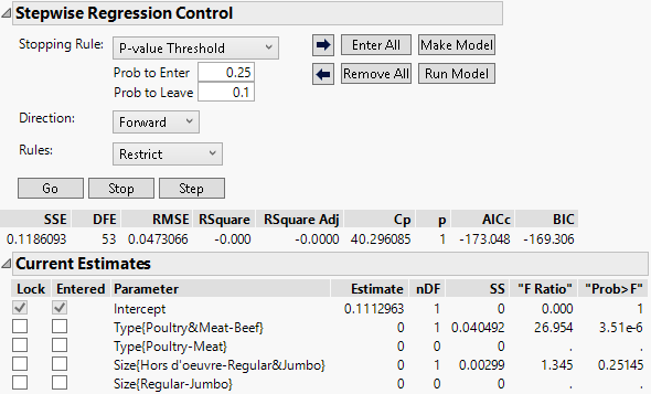

Figure 5.17 Stepwise Regression Control Panel with P-value Threshold and Restrict Rule
Notice that when you switch from the default Rule of Combine to Restrict, the F Ratio and Prob > F values for two terms, Type{Poultry-Meat} and Size{Regular-Jumbo}, are shown as missing. This occurs because these two terms cannot enter the model until their precedent terms enter.
