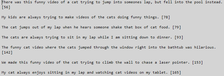

11. Image shown hereSelect the seven right-most points in the left SVD Plot.
These seven points represent survey responses that are clustered away from the rest of the points. To further investigate this cluster, you read the text of these responses.
12. Image shown hereClick the Show Text button that is above the left SVD Plot.
Figure 12.5 Text of Selected Documents
A window appears that contains the text of the seven documents represented by the selected points. These survey responses are similar in that they all refer to some combination of “funny”, “cat”, and “video”. These documents have larger positive values for the first singular vector than the rest of the documents. These larger values indicate that they are different from the rest of the documents in that dimension.
