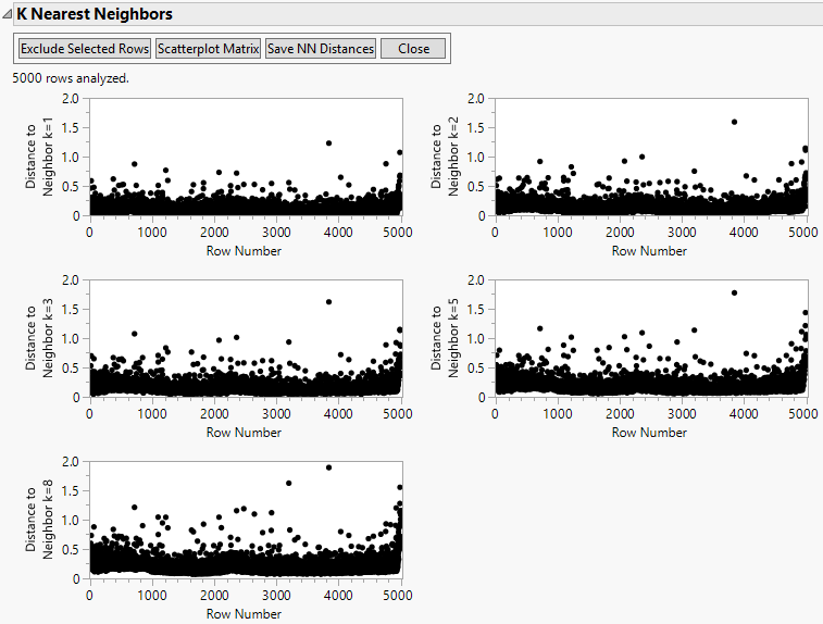

Figure 22.1 Multivariate k-Nearest Neighbor Outlier Example
