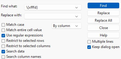

Text that JMP does not recognize is replaced with a Unicode character Image shown here. Find the text by searching for \x{fffd}.
1. In the data table, select Edit > Search > Find.
2. Type \x{fffd} next to Find what.
3. Make sure that Use regular expressions is selected.
4. Make sure that Search data is selected.
5. Click Find to find the first instance.
6. Replace all instances with another string.
Figure 3.13 Searching for the Unicode Character
