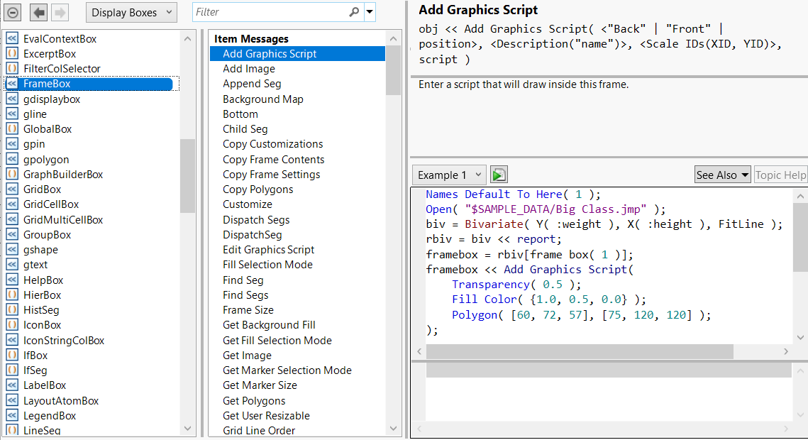

To find out which messages you can send to a frame box, select Help > Scripting Index and search for “frame box”.
Figure 11.6 Scripting Index Display Boxes List

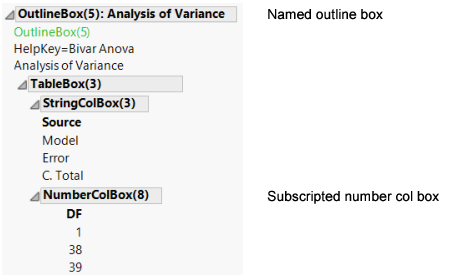

Subscripting Display Boxes for Compatibility
JMP might add or remove display boxes in a report from release to release, causing numbered subscripts to choose a different box. Using a string to index a box, followed by a numbered subscript to pick a specific child box, is more reliable across releases.
rp = dt << Bivariate(
	Y( :weight ),
	X( :height ),
	Fit Line( {Line Color( {213, 72, 87} )} )
Print(
	"C.Total DF=",
// string references the parent box
	Report( rp )[Outline Box( "Analysis of Variance" )][
	Number Col Box( 1 )][3] // subscript references the child box
Figure 11.7 Subscripted Display Box
The numbered subscripts (in the preceding example) are relative to the named box, which makes them less likely to change. However, this also means that the absolute numbers in Show Tree Structure can’t be used directly.
