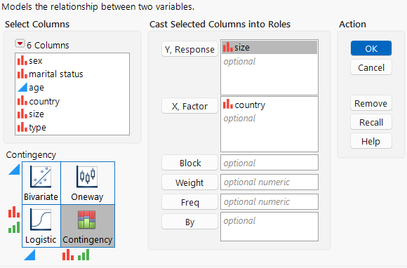

Launch the Contingency platform by selecting Analyze > Fit Y by X. The Fit Y by X launch window is used for four different types of analyses. When you enter an ordinal or nominal Y variable and an ordinal or nominal X variable, the Contingency platform is launched.
Figure 7.3 The Contingency Launch Window

Y, Response
The response variable or variables that you want to analyze. These variables must have an ordinal or nominal modeling type.
X, Factor
The predictor variable or variables that you want to analyze. These variables must have an ordinal or nominal modeling type.
