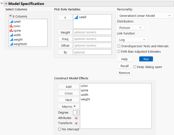

Launch the Generalized Linear Model personality by selecting Analyze > Fit Model, entering one or more columns for Y, and selecting Generalized Linear Model from the Personality menu.
Figure 13.4 Fit Model Launch Window with Generalized Linear Model Selected
For more information about aspects of the Fit Model window that are common to all personalities, see “Model Specification”. For more information about the options in the Select Columns red triangle menu, see “Column Filter Menu” in Using JMP. Information that is specific to the Generalized Linear Model personality is presented here.
If your model effects have missing values, you can treat these missing values as informative categories. Select the Informative Missing option from the Model Specification red triangle menu.
Tip: The No Intercept option is not available in the Generalized Linear Model personality of the Fit Model platform.
When you select Generalized Linear Model for Personality, the Fit Model launch window changes to include additional options. The following additional options are available in the Generalized Linear Model personality:
