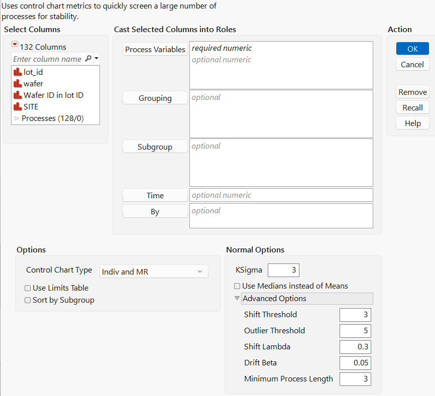

Launch the Process Screening platform by selecting Analyze > Quality and Process > Process Screening.
Figure 8.5 Process Screening Launch Window
Launch Window Roles
Process Variables
The columns of process data containing the measurements to be analyzed. The columns must have a Numeric data type. If a process variable has a Control Limits column property, the Process Screening platform uses those limits to calculate the Specified Sigma.

Grouping
Columns assigned as grouping variables. Each process variable is analyzed at each combination of levels of the grouping variables. The results are presented in a single report.
Note: Missing is considered a level for grouping variables.

Launch Window Options
Options
Provides options that apply to all control chart types.
Control Chart Type
Specifies one of the following control chart types: Indiv and MR (Individual Measurement and Moving Range); XBar and R; XBar and S; XBar, MR, and R; XBar, MR, and S; Count; Nonnegative Continuous; Proportion. The XBar, MR, and R control chart and the XBar, MR, and S control chart are also referred to as three way control charts. The Count, Nonnegative Continuous, and Proportion control charts are non-normal. For more information about statistical details, see “Statistical Details for Control Chart Builder”.

Use Limits Table
Enables you to import historical control limits and specification limits from a data table. When you select this option and click OK in the launch window, a Choose limits table window appears. Once you choose a limits table and click OK, a Limits Specification window appears. Assign columns in your limits table to appropriate roles and click OK. See Limits Table.
Note: If you do not select this option, limits and sigma values are obtained from the Control Limit, Spec Limit, or Process Screening column properties for the Process Variables. If you do not select this option and the Process Variables do not have control limit column properties, the control limits are calculated from the data.
Tip: To add columns properties to several columns at once, see “Manage Limits”

Normal Options
Provides options that apply only to normal control chart types.
Subgroup Sample Size
(Not available when the Control Chart Type is Indiv and MR.) Specifies a constant sample size for subgroups. The minimum subgroup size is 2. A subgroup size of 5 is the default. The Subgroup Sample Size specification is ignored when a subgroup variable is specified.
KSigma
Specifies the sigma multiplier. KSigma is the value that is multiplied by sigma in the calculation of control limits. By default, KSigma is 3.

Advanced Options
Contains the following options:
Shift Threshold
Specifies a value that controls the sensitivity of the Shift Graph. Shift Threshold is set to three by default. After outlier removal, the Shift Graph shows a plot of the time occurrence of all process shifts that exceed the number of within-sigma units specified by the Shift Threshold. See Shift Graph.
Outlier Threshold
Specifies a value that controls the sensitivity of outlier removal for detection of large recent shifts and for the Shift Graph. Outlier Threshold is set to five by default. If the number of within sigma units from an observation to both of its neighboring observations exceeds the specified Outlier Threshold, that observation is replaced with a value that is one within-sigma unit away from its closest neighboring observation. See Shift Magnitudes and Positions.
Shift Lambda
Specifies the weight that is used in the exponentially weighted moving average (EWMA) for shift detection. See Shift Magnitudes and Positions.
Drift Beta
Specifies the weight used in the Holt Double-Exponential Smoother for drift detection. Drift Beta is set to 0.05 by default.
Minimum Process Length
Specifies the minimum number of data values that a process must have in order to be included in the analysis. By default, this value is set to 3.
