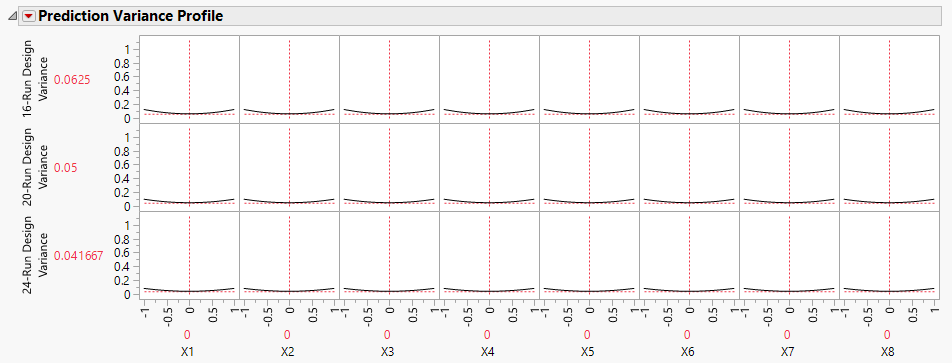

Prediction Variance Profile
In the Compare Designs report, the Prediction Variance Profile section shows profilers of the relative variance of prediction for each design being compared. Each plot shows the relative variance of prediction as a function of each factor at fixed values of the other factors.
To find the maximum value of the relative prediction variance over the design space for the reference design, select the Maximize Variance option from the red triangle next to Prediction Variance Profile. The value of the maximum variance in the Prediction Variance Profile is the worst (or least desirable from a design point of view) value of the relative prediction variance.
Figure 17.14 Prediction Variance Profile for Three Designs
Relative Prediction Variance
