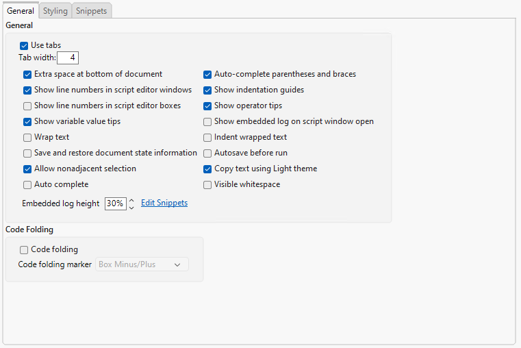

The Script Editor preferences are contained in three tabs: General, Styling, and Snippets.
Figure 15.21 Script Editor Preferences
Table 15.19 Preferences on the Script Editor General Page
Preference
Description
Use tabs
Select this option to enable tabs in your scripts. This option is selected by default.
Clear this option to replace any tab that you enter with spaces.
Tab width
Enter how many spaces a tab should indent. If you have disabled tabs, any tab you enter is replaced with the number of spaces specified. The default setting is 4.
Extra space at bottom of document
Select this option to enable scrolling up from the last blank lines of a script. This option is selected by default on Windows and deselected on Apple macOS.
Auto-complete parentheses and braces
Select this option to enable the script editor to automatically add closing parentheses, square brackets, and braces when you enter an opening one. This option is selected by default.
Show line numbers in script editor windows
Select this option to show the line numbers on the left side of the script editor. This option is selected by default.
Show indentation guides
Select this option to see faint vertical lines that mark indention. This option is selected by default.
Show line numbers in script editor boxes
Select this option to show the line numbers on the left side of script editor boxes (such as in the Scripting Index). This option is off by default.
Show operator tips
Select this option to see tooltips for JSL operators. This option is selected by default.
Show variable value tips
Select this option to see tooltips for variable values. This option is selected by default.
Show embedded log on script window open
Select this option to show an embedded log window in the scripting window when editing or running scripts. This option is off by default.
Wrap text
Select this option to always wrap text in the script editor. This option is off by default.
Indent wrapped text
Select this option to indent wrapped text by one tab space in the script editor. This option is off by default.
Save and restore document state information
Saves the state of collapsed and expanded code, and restores that state when the script is reopened.
Autosave before run
Automatically saves the script before you run it. This option is off by default.
Allow nonadjacent selection
Enables you to select text that is not adjacent. Press Ctrl on Windows or Command on Apple macOS and drag your cursor over the text. Continue this action for any other text that you want to select. This option is selected by default.
Copy text using Light theme
Determines whether the background color of the code is pasted to another document. This option is selected by default. This means that, when the Light theme is selected in the Script Editor preferences, the code is pasted with a light background into another document.
Autocomplete
Suggests completions for text as you type, based on context and known keywords.
Visible whitespace
Displays spaces, tabs, and line breaks using visible markers in the editor.
Embedded log height
Specifies the height of the embedded log in a script window. The default setting is 30%.
Code folding
Select this option to use code folding markers in the script editor, which mark the opening and closing of user-defined functions and Expr() blocks. You can expand and collapse these marked blocks of code. This option is off by default.
You can also choose the appearance of the marker using the JSL code folding marker menu. See “Add Code Folding Markers” in the Scripting Guide.
Code folding marker
Specifies the type of marker used to indicate when code is being folded. This option is available when Code folding is enabled. Choose from the following markers:
• Arrow Down/Up
• Minus/Plus
• Circle Minus/Plus
• Box Minus/Plus
This option is set to Box Minus/Plus by default.
Highlighting style
Specifies how matching elements are visually marked in the script editor when highlighting. Choose from the following styles:
• Highlight
• Boxed
• Underline
This option is set to Highlight by default.
Highlight instances of the word under the cursor
Specifies whether to highlight all other occurrences of the word currently under the text cursor.
Highlight instances of the current selection
Specifies whether to highlight all text that matches the current selection.
Enable highlighting in log
Enables syntax or pattern-based highlighting in the log and embedded log.
