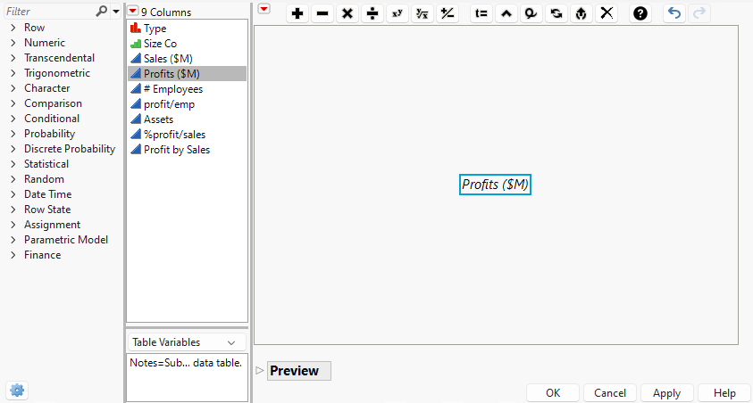

5. With the box selected, select Profits ($M) from the Columns list.
Figure 7.3 Adding the Profits ($M) Column
