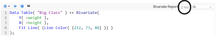

Elapsed Time
After you run a script, the elapsed time for each block is displayed in the upper right of the block.
Figure 17.5 Elapsed TimeĀ
Elapsed Time
To clear the elapsed time, right-click it and select Hide.
