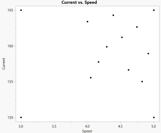

13. From the Augmented Design table, select Graph Builder.
14. Drag Speed to the X drop zone and drag Current to the Y drop zone.
15. Click the Smoother icon to remove the smoother.
Figure 6.18 Space Filling Augmented RunsĀ
The augmented runs fill the space in the upper right corner of the design space. This is the constrained design space.
