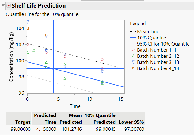

When you click OK, a Shelf Life Prediction report is added to the report window. The report contains a plot and a table.
Figure 8.12 Shelf Life Prediction Report
The plot shows the individual observations for the batches as well as lines for the mean, quantile, and specified intervals. The table contains information that is based on the options that were specified in the Shelf Life Prediction window.
Target
The specified acceptance criterion value.
Predicted
The value of the time variable at the intersection of the specification limit and the line for the specified prediction method. This is the value that is used to estimate the shelf life.
Mean Predicted
The marginal mean prediction at the predicted time.
The remaining columns in the table depend on the prediction method and whether a one-sided or two-sided interval is specified.
